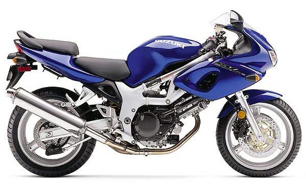

1999 Suzuki year code: X

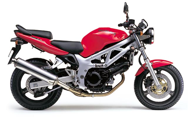

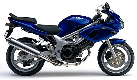

The SV650 and SV650swas released in 1999 in Europe. The naked version of the SV650 is also sometimes called SV650N. I think Europe got Yellow, Red, Blue and Black. The blue was called Candy Blue Jay and only appeared for the 1999 models.
North America it was available in two colours, red and blue, and only without the fairing. The Canadians got lucky and also got the 'S' model. It was quite common for US owners to buy their 'S' models north of the border and import them back.
Overall Length: 2 045 mm (80.5 in) - Overall Width: 760 mm (29.9 in) - Overall Height: 1 060 mm (41.7 in) - Seat height: 805 mm (31.7 in) - Wheelbase: 1 420 mm (55.9 in) - Ground Clearance: 140 mm (5.5 in) - Dry Weight: 165 kg (364 lbs) - Engine type: Liquid-cooled 645 cc V-twin, DOHC, 8 valves. 70 hp (51.1 kW)/ 9.000 rpm, 62 Nm/ 7.500 rpm.
Overall Length: 2 045 mm (80.5 in) - Overall Width: 740 mm (29.1 in) - Overall Height: 1 130 (44.5 in) - Seat Height: 805 mm (31.7 in) - Wheelbase: 1 420 mm (55.9 in) - Ground Clearance: 140 mm (5.5 in) - Dry Weight: 169 kg (372 lbs) - Engine type: Liquid-cooled 645 cc V-twin, DOHC, 8 valves. 70 hp (51,5 kW)/ 9.000 rpm, 62 Nm/ 7.400 rpm

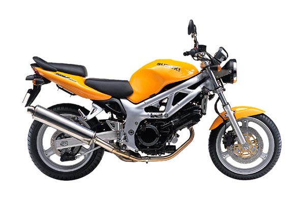

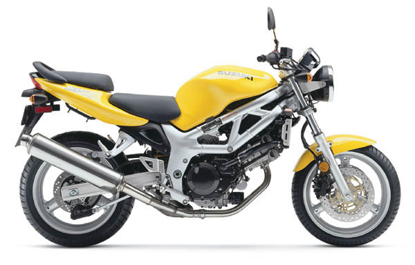

2000 Suzuki year code: Y
Suzuki made some modifications to the engine between the 1999 and 2000 model. An oil scraper plate in the earlier engine was originally cast into the casings but this was replaced in the 2000 model with a steel version that was bolted in place.  During early production of the 2000 engine a number of bikes left the factory without the oil scraper and a recall was issued for those bikes to have them retro fitted.  It was an odd change to make and it fuelled speculation that Suzuki were planning a 750cc version of the engine which required a bigger crank and therefore a smaller scraper. The only other changes I can think of are cosmetic.  The light blue colour was replaced with a darker blue and the wheels got painted in graphite black.

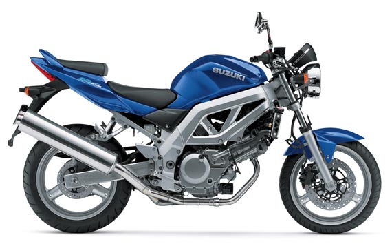

2002 Suzuki year code: K2
Not aware of any major changes apart from the fork pre-load adjusters that we'd all been shouting for. Choice of colours extends to include silver. The yellow changed too.
Overall Length: 2 045 mm (80.5 in) - Overall Width: 740 mm (29.1 in) - Overall Height: 1 130 (44.5 in) - Seat Height: 805 mm (31.7 in) - Wheelbase: 1 420 mm (55.9 in) - Ground Clearance: 140 mm (5.5 in) - Dry Weight: 169 kg (372 lbs) -Engine type: Liquid-cooled 645 cc V-twin, DOHC, 8 valves. 70 hp (51,5 kW)/ 9.000 rpm, 62 Nm/ 7.400 rpm

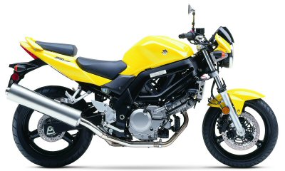

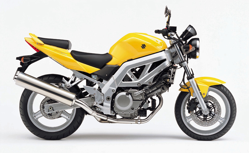

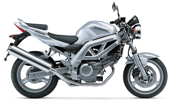

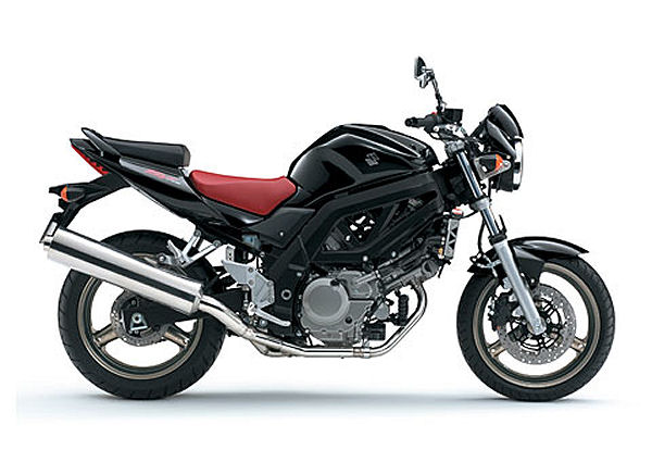

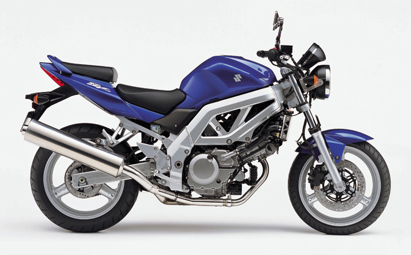

2003 Suzuki year code: K3

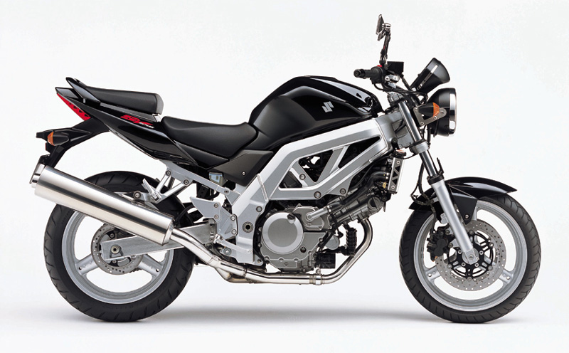

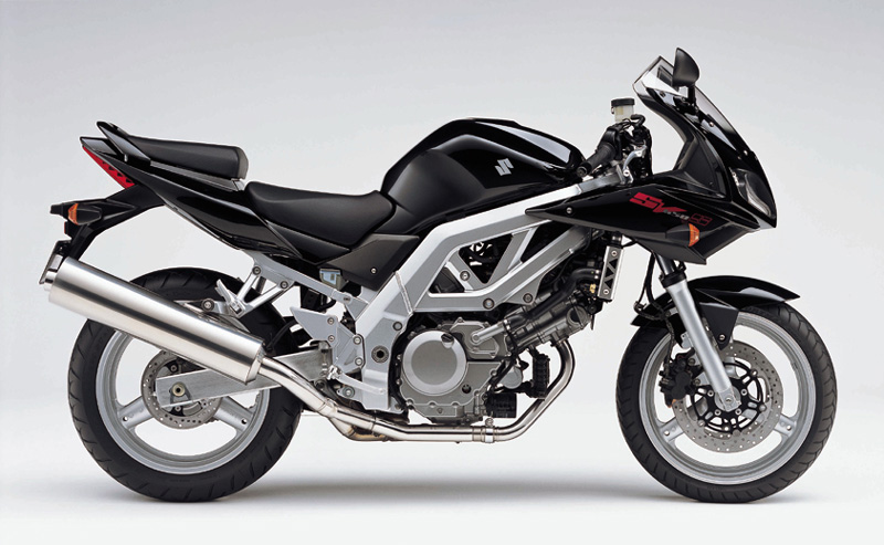

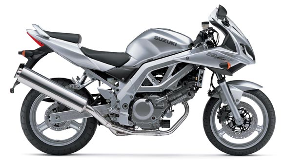

A totally redesigned SV650 was introduced for the 2003, simultaneously with its big brother, SV1000, the successor for the TL1000. The SV650 got a similar new aluminium frame as the SV1000 and same design. The engine delivers the same output as on earlier models, but the carburettors have now been replaced by electric fuel injection, featuring the Suzuki Dual Throttle valve System (SDTV) and Auto Fast Idle System (AFIS). Also the
In spite of their identical appearance, the SV650 and 1000 have nevertheless each one a framework specific and dimensioned to accomodate engines necessarily more or less bulky and powerful. Another evolution of size, the SV650 has upgraded with electronic injection, coupled to an injection of air to the exhaust and with a catalysed silencer.
One notices the rather massive head of fork of the SV650S and the curious bars of leds of the rear light. New is also the instrument panel with the central rev counter, the window with liquid crystals for speed, mileages, the temperature engine, the clock and the indicator of reserve. Apart from the new appearance, the SV650 remains very close to the old model (only the footing increases by 15 mm) and quite as comparable with the SV1000
Overall Length: 2 045 mm (80.5 in) - Overall Width: 790 mm (31.1 in) - Overall Height: 1 030 mm (40.6 in) - Seat Height: 800 mm (31.5 in) - Wheelbase: 1 420 mm (56.5 in) - Ground Clearance: 140 mm (5.5 in) - Dry Weight: 165 kg (364 lbs)
Engine type: Water-cooled 645 cc v-twin DOHC, 8 valves. 70 hp (51,5 kW)/ 9.000 rpm, 61,7 Nm/ 7.400 rpm
Overall Length: 2 045 mm (80.5 in) - Overall Width: 750 mm (29.5 in) - Overall Height: 1 130 mm (44.5 in) - Seat Height: 805 mm (31.7 in) - Wheelbase: 1 420 mm (55.9 in) - (5.5 in) - Dry Weight: 169 kg (372 lbs) - Engine type: Water-cooled 645 cc v-twin DOHC, 8 valves. 70 hp (51,5 kW)/ 9.000 rpm, 61,7 Nm/ 7.400 rpm.

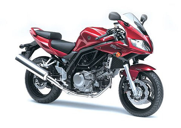

2004 Suzuki year code: K4
Changes for this year include Subframe lowered 40mm for more comfortable passenger seating position, more compact rear fender. The subframe also appears to be made of aluminium too. Toolkit under the battery box accessed from the outside. Like most of the '04 Suzukis, there's only the classic Suzuki "S" logo on the fuel tank, instead of the company name ”Suzuki”.Colors available: Blue, Black, Yellow. Slight increase in power.
Overall Length: 2 080 mm (81.9 in) - Overall Width: 745 mm (29.3 in) - Overall Height: 1 085 mm (42.7 in) - Seat Height: 800 mm (31.5 in) - Wheel Base: 1 440 mm (56.7 in) - Ground Clearance: 150 mm (5.9 in) - Dry Weight: 165 kg (363 lbs)
Engine type: Water-cooled 645 cc v-twin DOHC, 8 valves. 72 hp (53 kW)/ 9,000 rpm, 64 Nm/ 7,200 rpm.
Overall Length: 2 085 mm (82.7 in) - Overall Width: 730 mm (28.7 in) - Overall Height: 1 170 mm (46.1 in) - Seat Height: 800 mm (31.5 in) - Wheel Base: 1430 mm (56.3 in) - Ground Clearance: 155 mm (6.1 in) - Dry Weight: 169 kg (372 lbs) Engine type: Water-cooled 645 cc v-twin DOHC, 8 valves. 72 hp (53 kW)/ 9,000 rpm, 64 Nm/ 7,200 rpm

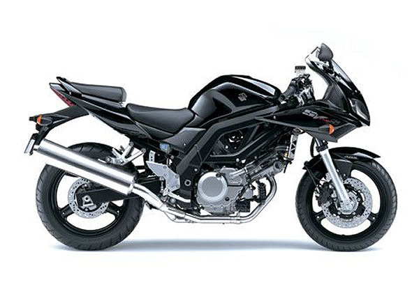

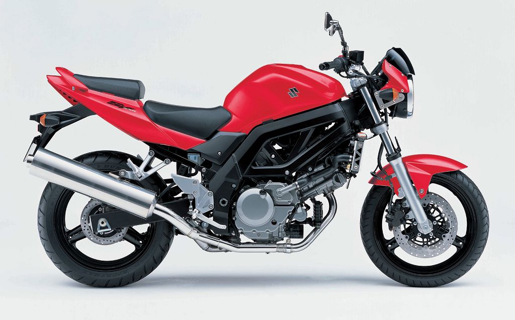

2005 Suzuki year code: K5

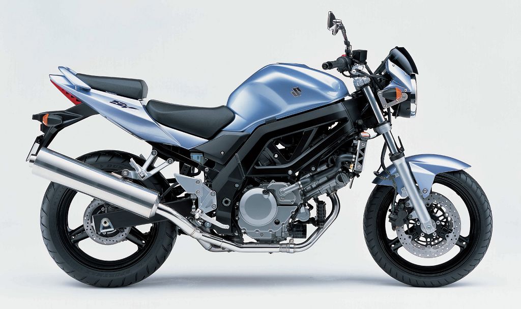

Suzuki have followed the trend for matt black frames this year. Looks hideous to me, too much black. The small screen shown here may be standard in the US and yellow was not available in the UK.
Dry weight: 165.0 kg (363.8 pounds) Seat height: 800 mm (31.5 inches) If adjustable, lowest setting. Overall height: 1,085 mm (42.7 inches) Overall length: 2,080 mm (81.9 inches) Overall width: 745 mm (29.3 inches) Ground clearance: 150 mm (5.9 inches) Wheelbase: 1,440 mm (56.7 inches) Displacement: 647.00 ccm (39.48 cubic inches) Engine type: V2 Stroke: 4 Compression: 11.5:1 Bore x stroke: 81.0 x 62.6 mm (3.2 x 2.5 inches) Fuel system: Injection Valves per cylinder: 4 Fuel control: DOHC Cooling system: Liquid Gearbox: 6-speed Transmission type final drive: Chain

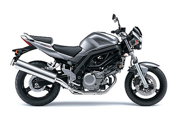

2006 Suzuki year code: K6

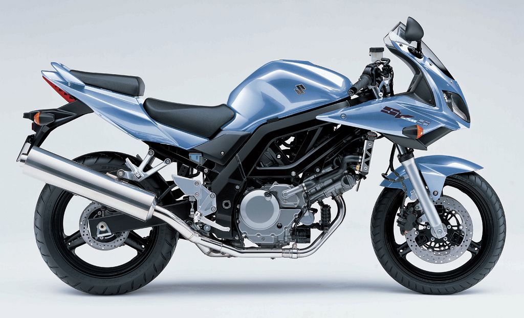

Not much to say except just some colour changes until the next big makeover in 2007?

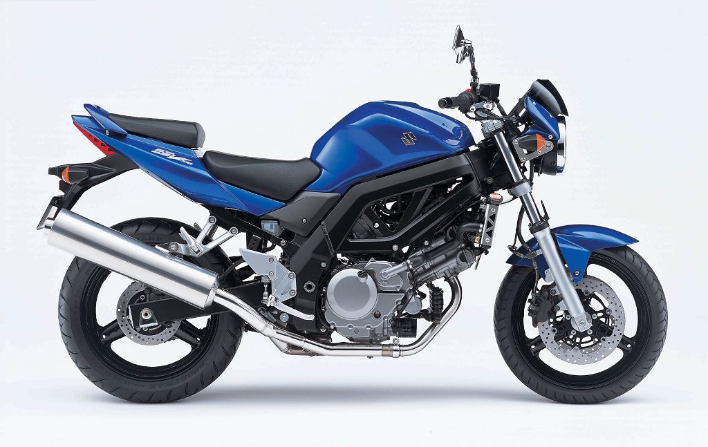

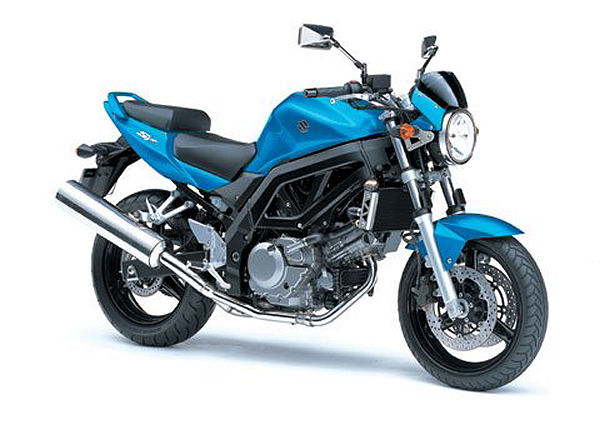

2007 Suzuki year code: K7
A lot of conjecture over this at the moment. There has been no announcement from Suzuki at the moment. The US version is reported to have inherited the same twin spark plug engine as fitted to the DL650. It also has an ABS option. No news of the GB version, except that the Suzuki GB website shows new colours and I can see an extra spark plug in the images. There is also a photo of the front wheel with ABS hardware fitted and a nice ABS sticker on the mudguard. So we'll just have to wait and see. John - November 2006.

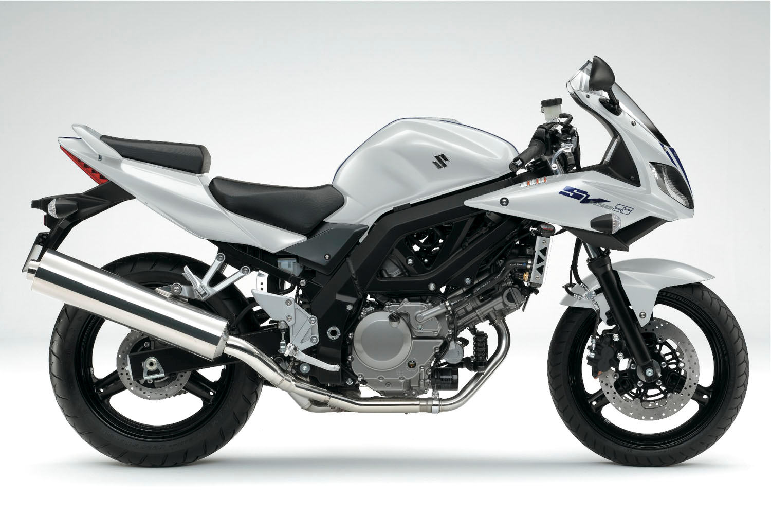

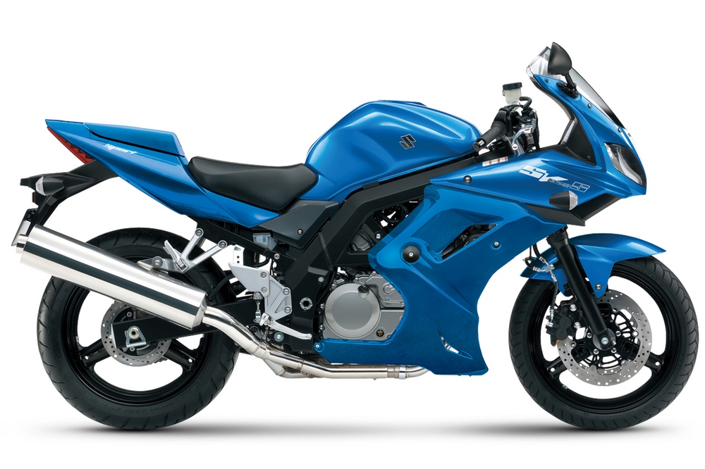

2008 Suzuki year code:k8

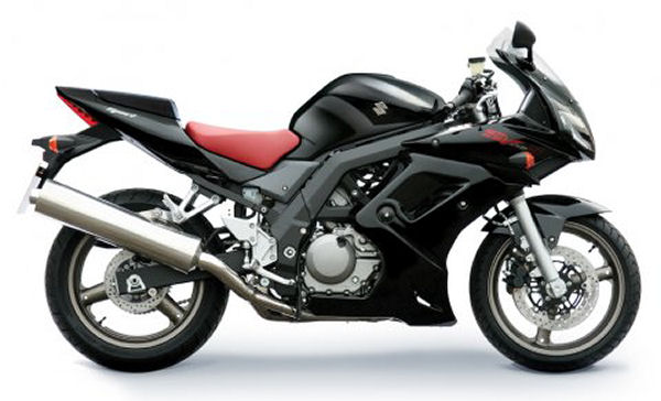

Reading my comments above one 18 months on is interesting. The ABS and twin spark head never did appear and the model line up looked just like 2006. The only big announcement was for the special edition SV650s Sport. Basically the SV650s with a full fairing and tail cover. Perhaps a effort to give flagging sale a bit of a boost. It is a good value option though, as sourcing these parts separately would cost you more. The Sport model also appears in 2008 with some interesting colour options. John March 2008

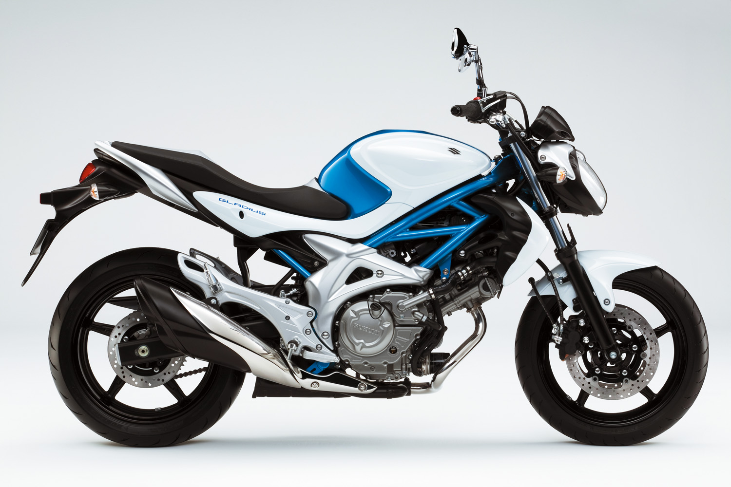

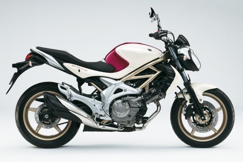

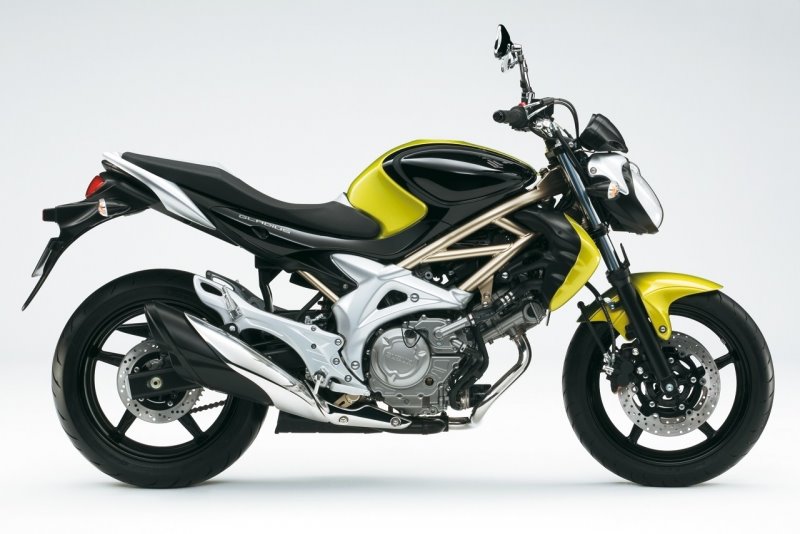

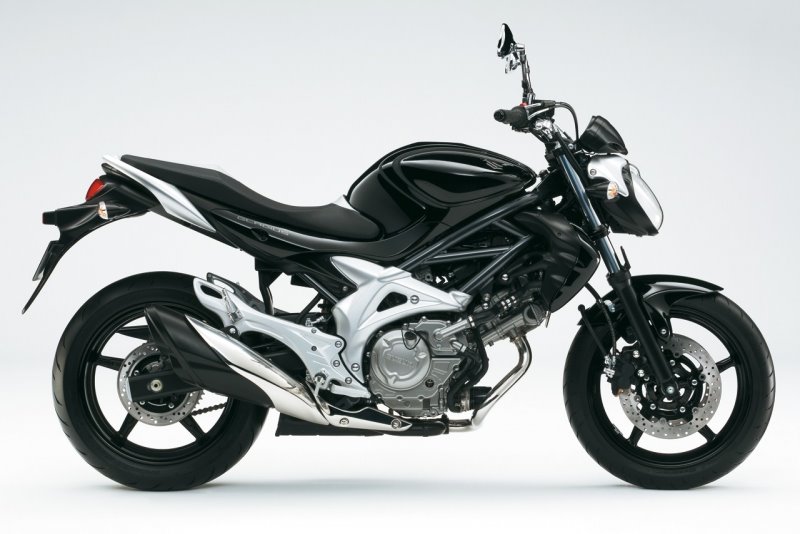

2009 Suzuki year code:k9
I thought this year would see some major announcements as this is the SV's 10th Anniversary.  The recent Paris bike show had Suzuki announce the Gladius which may or may not be the replacement of the SV650n.  Suzuki US have announced that they will no longer list the SV650n, which makes sense as the two naked models are so similar.  The only news I can see so far on the S is the photo shown below. Just another make over. The blue model has a nice white strip down the centre of the bodywork which should add another 10bhp.  Note also the clear indicators. Have Suzuki have run out of ideas?  Rumours are also circulating that the SV range will be dropped by Suzuki.  I doubt they would do that, as it's always been a good seller.  The SV range is not dissimilar to the Bandit. The Bandit has always been a good steady seller and has slowly evolved, I would have thought the SV would follow a similar path.
