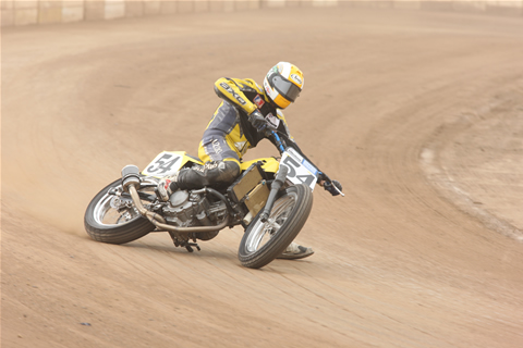

		October 5th - Flat tracker. Came across this advert the other day. Brilliant. THUNDERBIKE CHAMPIONSHIP WINNING MACHINE FOR SALE, SV650 INJECTION ENGINE IN A ROGER COTTERAL FLAT TRACK MONOSHOCK FRAME.THIS BIKE HAS WON MANY RACES AND THREE CHAMPIONSHIPS.THE ENGINE IS AN 'O5 INJECTION WITH MILD TUNE IN EXCELLANT CONDITION. R6 FORKS, KOSMIC CLAMPS, FIVE ONE WHEELS, CARBON CAN, PENSKI SHOCK, WOODS TANK AND C&J SEAT, ELECTRIC START, SOME SPARES  |
