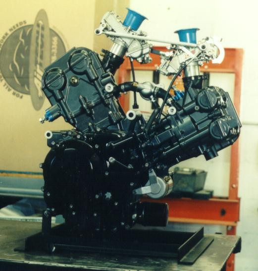

23/12/99 Image of a 677cc SV from Germany...this is one mean looking SV...very very nice...
We are a german Suzuki Dealer and fit out a SV 650 with Raceparts from Großewächter Germany, because the bad weather we drive only 250km. At 1000 km we planed a dyno run ,the result we will mail to you.
Click for image of the 677cc SV
Email ZT-Visbek@web.de

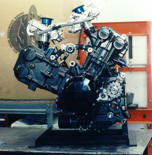

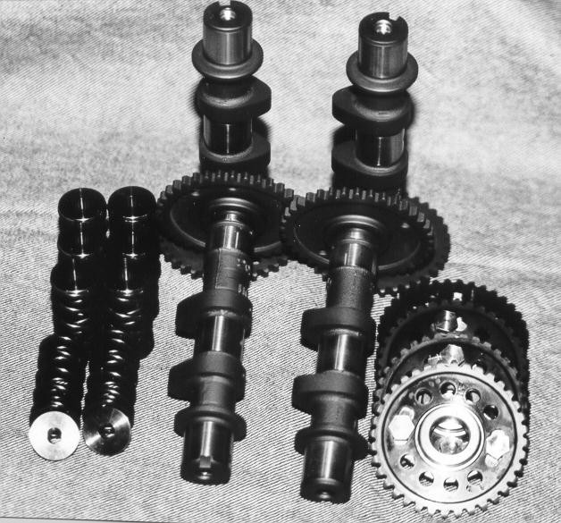

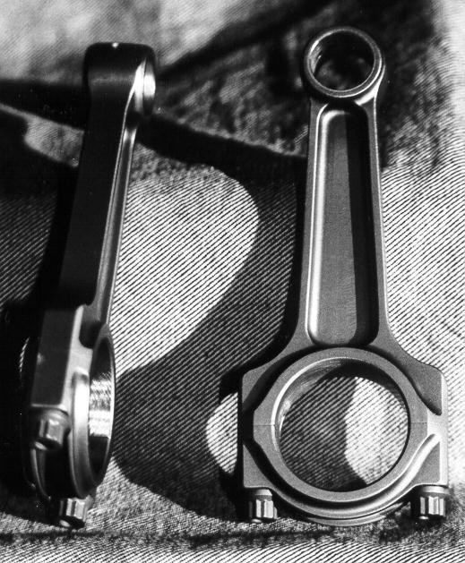

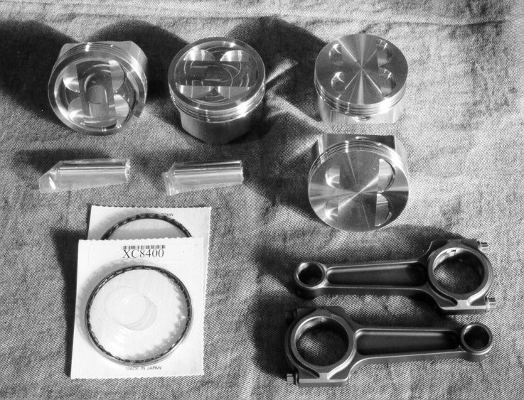

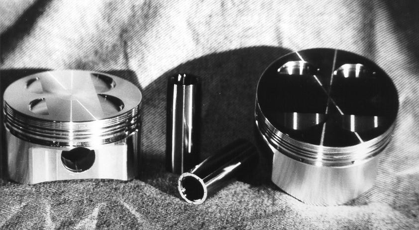

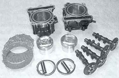

22/12/99 TIGCRAFT 750cc CONVERTION - MCN feature initial reports of the 750cc upgrade - Thanks to Nick (nick_hall@europe.adaptec.com) for the information...
Picked this link up this morning - what a headline! Spend £1500 on your SV and start chasing 748's! Of course, we could always chase them and remain closer than any Ducati rider could think possible, but now an SV could be right in the wing mirrors! This is the Tigcraft 750cc conversion that a few people have mentioned before, but they haven't put it on a dyno yet. I'm sure the bhp numbers will be interesting.....

19/12/99 727CC TUNING KIT - Peter (pit_strull@yahoo.com) sends in this information....thanks..
Serwas to all SV650 Riders out there,
this is a message to Santa Clause.
We wish us a 727 ccm Kit & an Arrow Exhaust System & Dynojetkit. So our SV will have 100 HP.
The 727 ccm Kit is available at:
Großewächter (Grossewaechter) (Germany)
Address: Soar 25, 32139 Spenge
Telefon: 05225 859256
url: ?
Click for image
Infos 'bout the Arrow Exhaust System:
www.arrow.it; www.takeparts.com
The dynojetket is especially designed for the arrow exhaust system.
Now Santa Clause knows where to get this stuff, we hope the best.
happy x-mas from cold and rainy Vienna

19/12/99 SV parts...contact below...
I am sending more Pic's, only in jpg's. See Barry's previous post    See engine part images...  Image 1    Image 2   Image 3     Image 4    Image 5
SEEVERS Racing Development Co.
Ph.661-266-3779 USA.
Fax. 661-265-8122
srd@earthlink.net

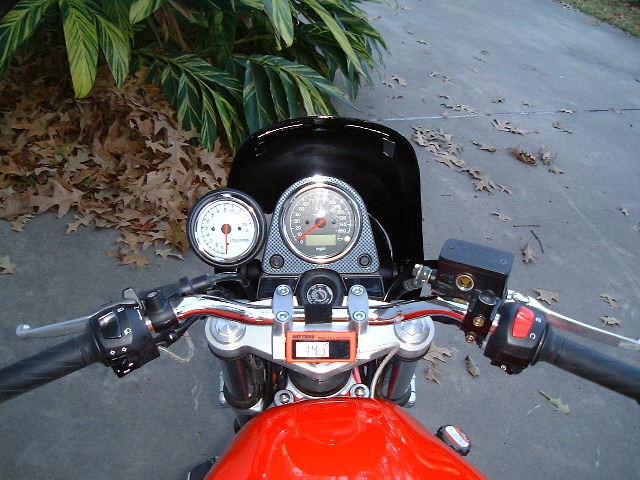

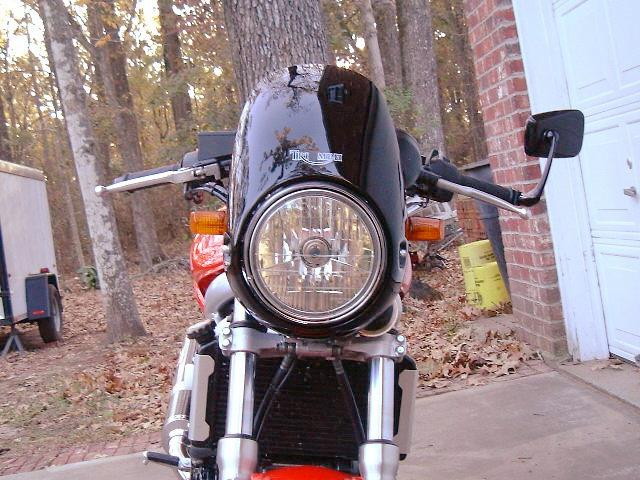

15/12/99 Fly screen images from Kerry (kcmdrisk@email.msn.com)...
Here are a few pictures of the Triumph fly screen on my SV. Please post if you like.  (I do like your can!!) ...... Image 1  Image 2    Image 3     Image 4

09/12/99 Some images of Rich's (richardw@lsdicon.com) SV....
Here are few photos I took of my bike today. I'm sending them to a few friends in far away places, thought you might like them too. I know its just a standard machine, but nevertheless, she's a damn fine bit.
Image 1       Image 2       Image 3        Image 4        Image 5       Image 6    Image 7
09/12/99 SV race parts anyone? If so contact Barry (srdco@earthlink.net)...
I am sending you some pic's of my Race parts for SV650 Suzuki.  Click for image.
