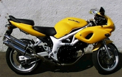

29/09/99 Thanks for the images Sylvain (sylvain.st-onge@cgocable.ca)....hope the weather keeps good for you..
Hi Kevin! Just took those new pictures of my SV with a digital camera (Canon A5 Zoom). We both have put 10,000Km on our bikes my girlfriend (the girl with an helmet on the red one in your pics ) and i, with no problem at all. Still another month to ride here in Quebec, but what a summer! Keep the good work!
Image 1           Image 2           Image 3
