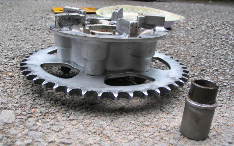

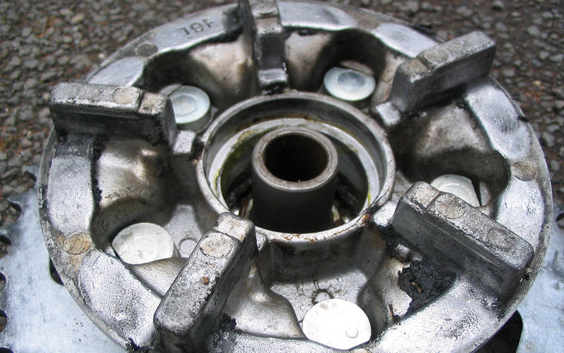

      21 May - If something looks wrong or
		feels wrong then it probably is wrong. That's how I felt yesterday when re-fitting the rear wheel. For some reason there seemed to be a slightly bigger space between the ends of the swing arm, did I leave out a spacer? Not that I can see. One wheel, one sprocket carrier, two spacers, one each side of the wheel and the brake carrier. Odd. Yet there seems to be an 3-5mm gap. I tightened up the axle and the space soon disappeared, probably my imagination. I span the wheel, it seemed slightly tight, so I loosened off the axle nut, that improved things and the wheel spun fine. Alarm bells where now going off in my head. You can tighten the axle as much as you want and it should not put any lateral pressure on the bearings. At this point the penny dropped. Did I check that the spacer that goes in the sprocket carrier was present? Only one way to check. Off came the wheel, popped of f the sprocket carrier, no spacer. So where the hell did that go? A quick check in the garage soon located the item. I had removed the wheel the night before and put all the parts on the work bench. The spacer must have slid out overnight and when I later picked up the carrier the space got left behind. Now I'm usually fairly careful when it comes to this spacer. Back in 1979 a bunch of us went to the IOM for the TT. A friend had a Suzuki GT550 and it broke down with a failed bearing in the sprocket carrier. Guess what was missing, yep the spacer. My friend had forgotten about the spacer, and tightened up his axle putting lateral pressure on the bearing. It got him from London to the IOM and then collapsed. Without the carrier being held properly in place the rear spocket could move around alarmingly along with the chain. Getting him home was another story. So the moral of the story, is check your work and if you suspect that something isn't quite right, take it apart and check, don't ignore it.  |
